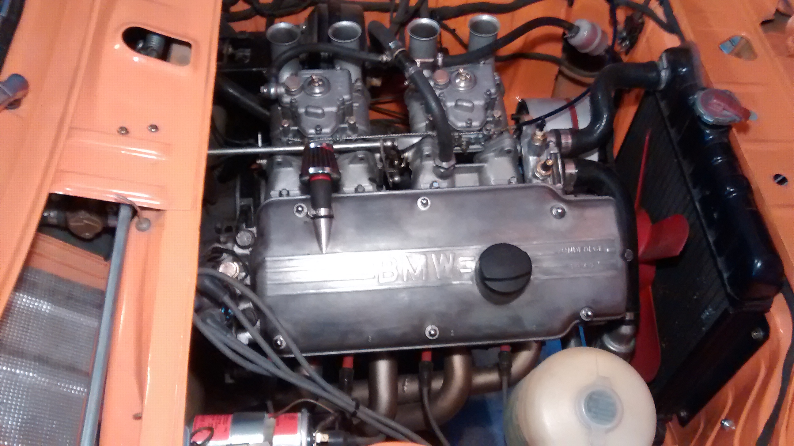

I have a set of weber 40's on my car, the problem is the chokes, or starting circut. I disassembled them to put in a rebuild kit they are working fine except the chokes.
When I pull the choke it stalls the motor immediatly, unlike before when I pulled the choke it nicely increased the rpm. I'm wondering if anyone has any idea what I did wrong and where I should begin to solve this problem.
Thanks

"immediately dies" sounds like they're either dumping a ton of fuel, or leaking a ton of air.
As long as the pistons are synchronized, there's not a ton that can go wrong with them if
they're moving up and down with the linkage.  The linkage inside the carb's a bit
low- quality- is it possible you bent something, or got one of the lifting fingers on the wrong groove in the piston?

If a 40/45 is tuned right, in colder climates the choke circuit makes life a lot easier on a street car.
Cold or warm weather if the car has not run for a couple days it requires lots of peddle pumping to get it started. Before I messed with it it just fired right up
with a bit of choke. Thanks for the input when get around to it I'll try a few things out hopefully it's a simple fix.
Cheers Erich
73, tii
I find using the chokes makes starting much easier than whanging away on the gas peddle. A few turns, it fires cleanly. I had to run a universal choke cable around the front to get the arms pulling in the right direction. California might be a different situation.
