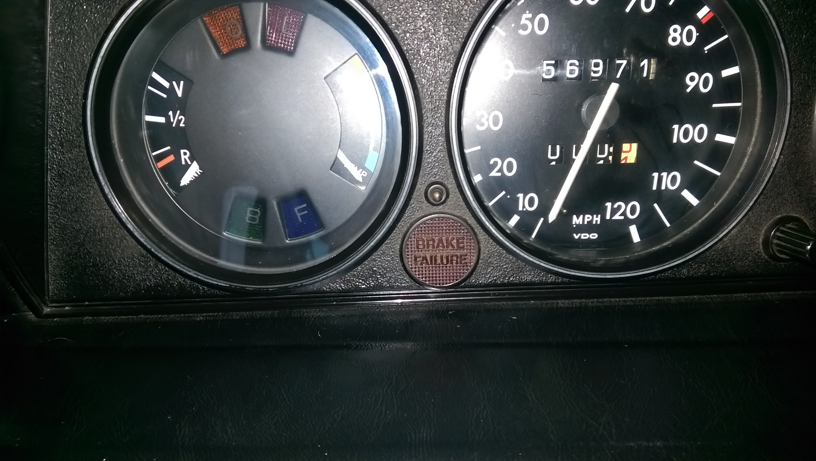

73 tii instrument cluster gauge
Nader
That part is not available separately. Finding a used cluster body is your best bet.

Unless you suspect the warning light is not functioning, I would not fret too much about the lack of a test button.
The cross hairs imprinted on left gauge containing fuel and temp is obviously from a later '74-'76 gauge set.  I suspect that has something to do with your lack of a test button whereas the newer gauges did not have one.  It was completely eliminated -  per the example below. ;)   Notice that your other gauges are so-called "period correct" without the cross hair decoration or the faux wood decoration. .
Edited by avoirdupois
Bet you can find a teeny-tiny, momentarily on pushbutton switch that will fit the hole where yours is missing...check electronic supply houses...
