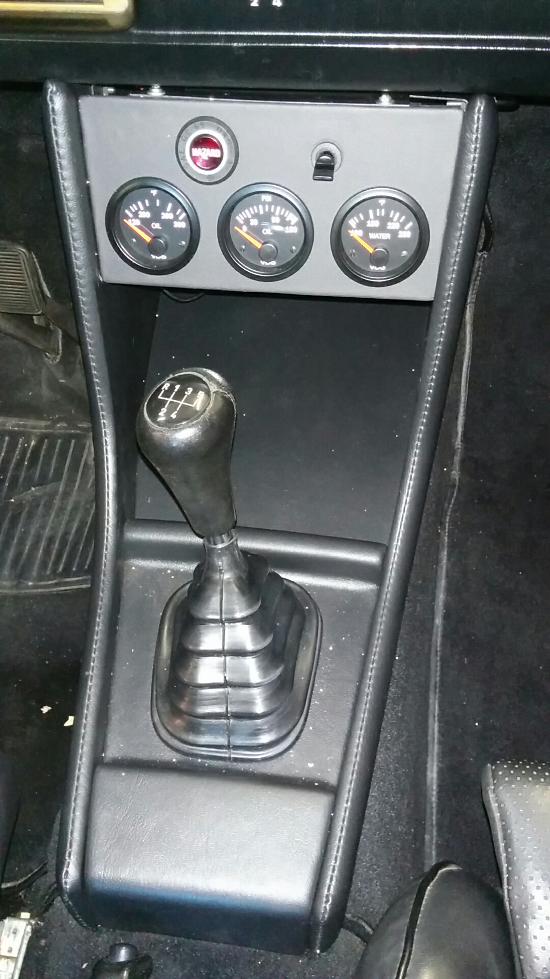

I just finished putting a set of gauges in my '72 2002tii.  I used the VDO gauges and the adapter from VDO for the oil pressure.  The senders and gauges for oil T and P from Bavairan Autosport.  Here are the part numbers I used:
oil pressure sender - 360 023
right angle adapter - 240 043K
oil pressure gauge - 350 108
oil temp gauge - 310 106
Hope that helps
Dave A.
'72 2002Tii
'74 Alfa Spider
I installed the oil temperature sender in the oil drain plug.  I found a VDO sender with 1/8" NPT and tapped a hole in a new drain plug.  I've only driven a couple times since installing them, but I can see that the oil temp is much lower than the water temp.  At least for the trips I've done so far.
The VDO oil pressure sender has two terminals.  One is for the oil warning light in the dash.  Just connect the original wire to this terminal.  The second terminal transmits the pressure signal to the new gauge.  You have to run a new wire for this.
The water temperature sender was mounted next to the stock sender.  This required taping a new hole in the little water manifold at the front of the engine.  We pulled the manifold off to do this.  The advantage of this approach is you can keep the stock sender and dash functionality while still getting very accurate temp readings on the new gauge.
