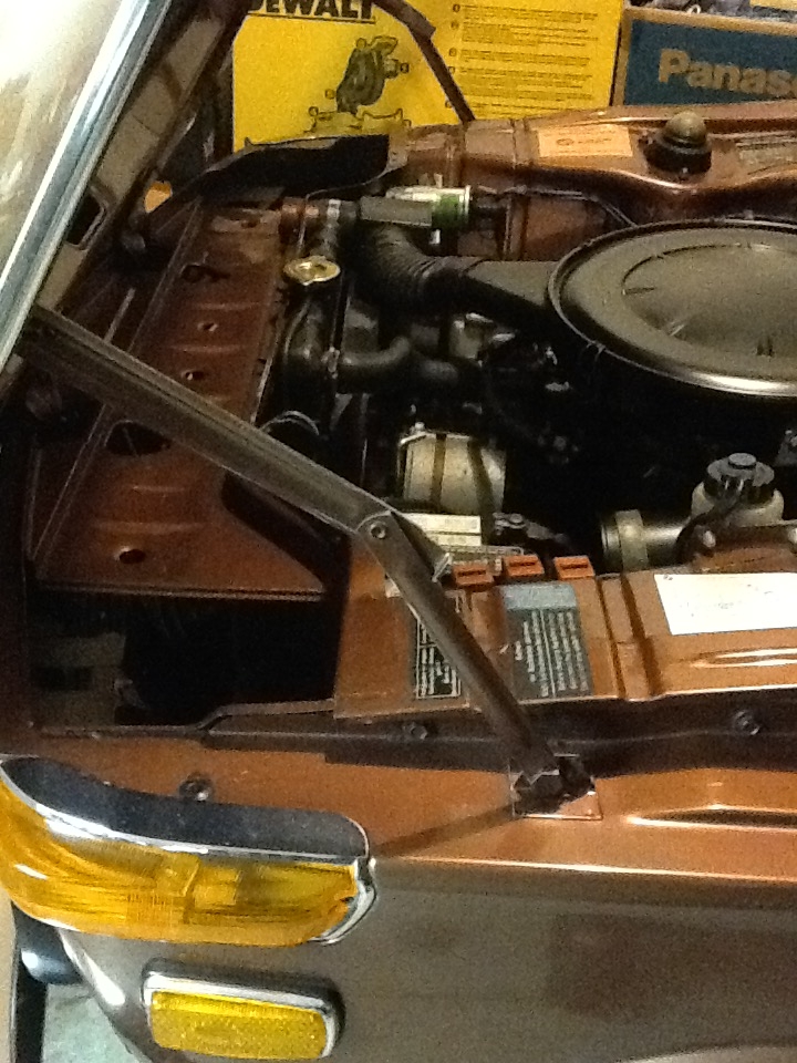

12 minutes ago, Buckeye said:
Here are a couple pictures of my car. Interesting I don't see bent tab at pivot point.
Yeah, I saw that too - but didn't know if that's some 'early-style' hinge or not.  Without that extended bent tab-stop, how's the hood lock-in the elbow at it's most up position?
But that difference wouldn't have much effect on the elbow position (off the apron) closed.
