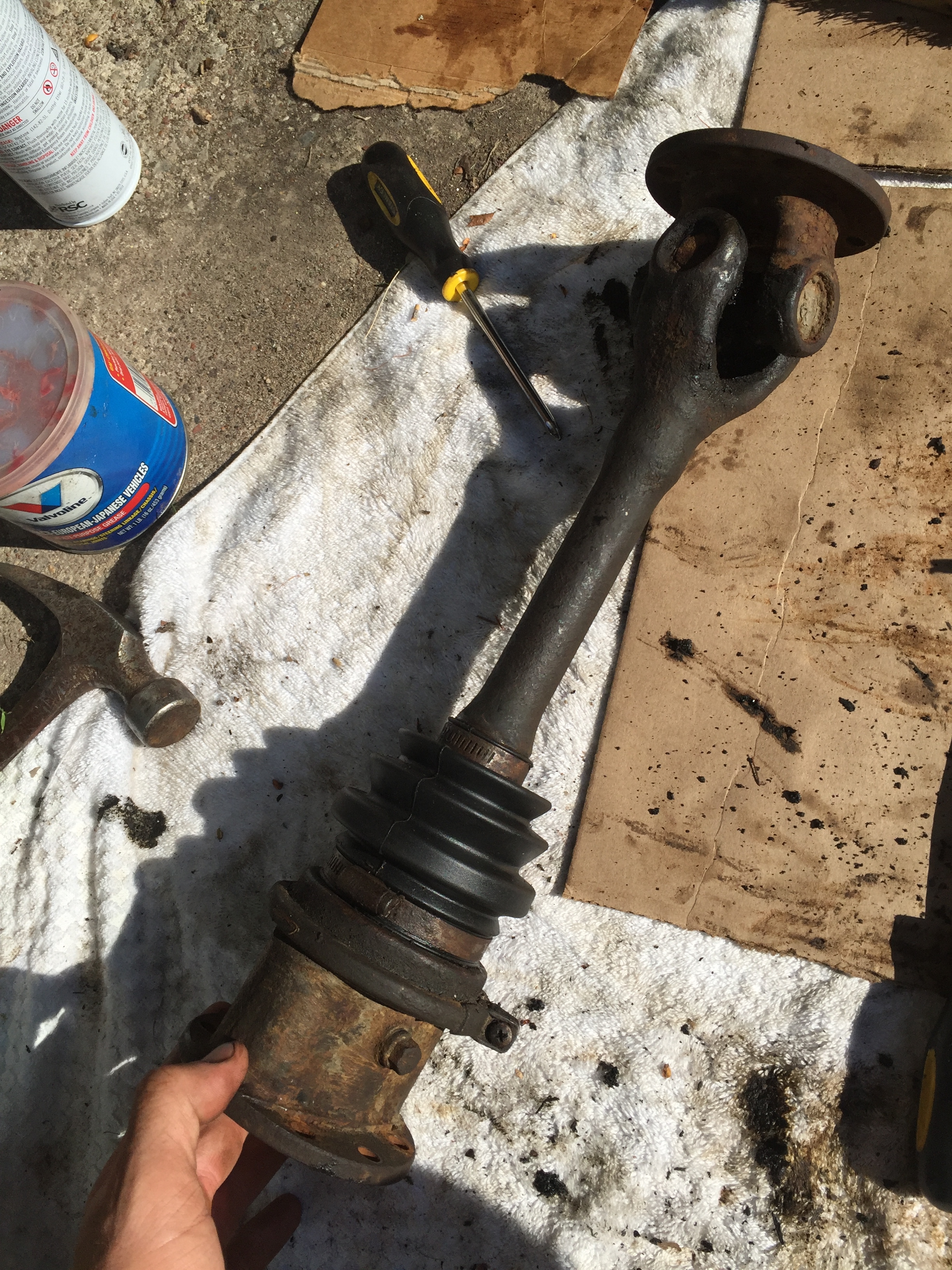

Please help. Replacing rear axel boots
JFINK907
+1 on the wrong boots.
The part at the right actually pulls off somehow (although I forget how, but it does come apart), revealing a sort of ball-hammer shaped end to the half shaft. Using witchcraft, heat and spoons, you somehow have to get the small end of the boot over that. "This is impossible", I hear you think. And it nearly is. But perseverance pays off, and oddly, the translucent yellow boots that you need are up to the abuse. An additional bonus is that you can see the oil level in there ...
Good luck!
Figured out how to get the boot on. Man that was a pain in the ass. I now know it's the wrong boot but it's gotta be better than no boot until I find the right one right? What's the differences in the different boots besides you can see the oil in one?
