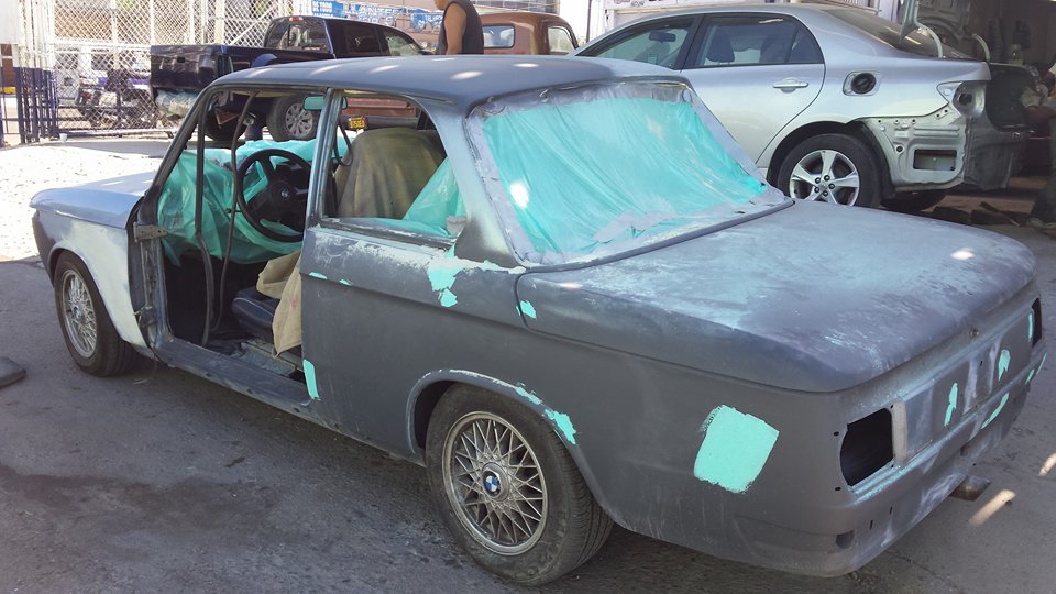

Car has been gone for a few weeks. Here are some pics of the progress. It's had all the holes filled from the euro bumper upgrade. The holes from the side markers and antenna in the a pillar filled. All minor dents and dings fixed. Extensive block sanding to get all panels perfect. Rust repair in the rear quarter. Door is removed for rust repair of the door. Getting close to final primer before paint. It's also getting a new headliner while its there as well. I have taken them all new seals for windows and trunk as well. I am having them paint my Ireland air dam but not install it. I'm very picky about fitment. image.jpegimage.jpegimage.jpegimage.jpeg

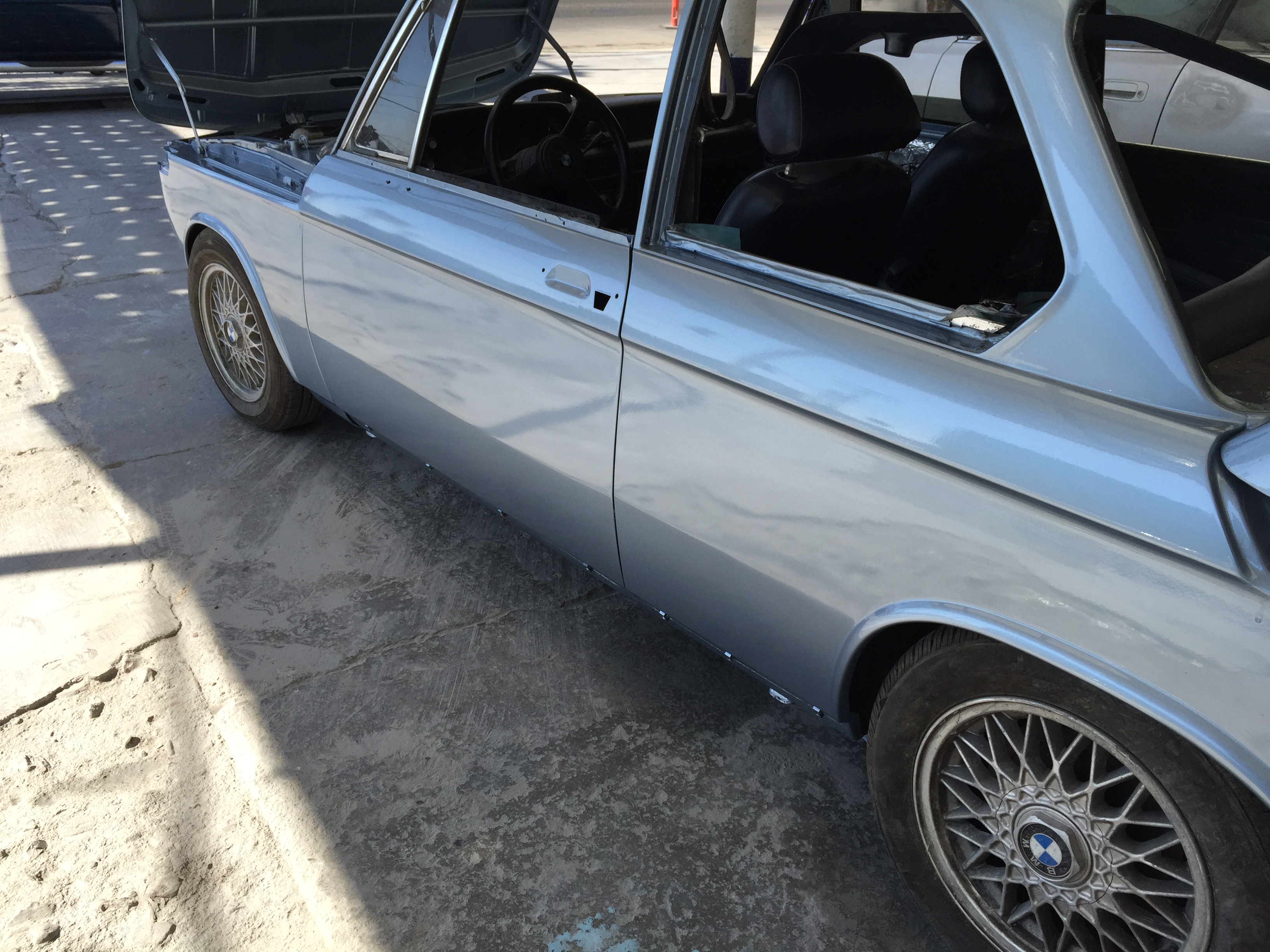

Update....car has been at the shop about a month.  It will get sprayed next week then a few days to let the paint cure, then wet sanding and polishing.  The current plan is all should be done in 2 weeks.  Here are pics of my visit to the shop today...
Both doors were BADLY rusted underneath as well as pretty significant rust on the lower third of the door.  Rust was cut out and new metal put in.   Drivers side door is back on the car and repaired.  Passenger side door is almost done.

Drivers side of car where it used to be very wavy with 40 years of dings as well as rippling from the previous owners attempt to fill the trim holes, I think the welding rippled the metal.  Now its COMPLETELY straight!

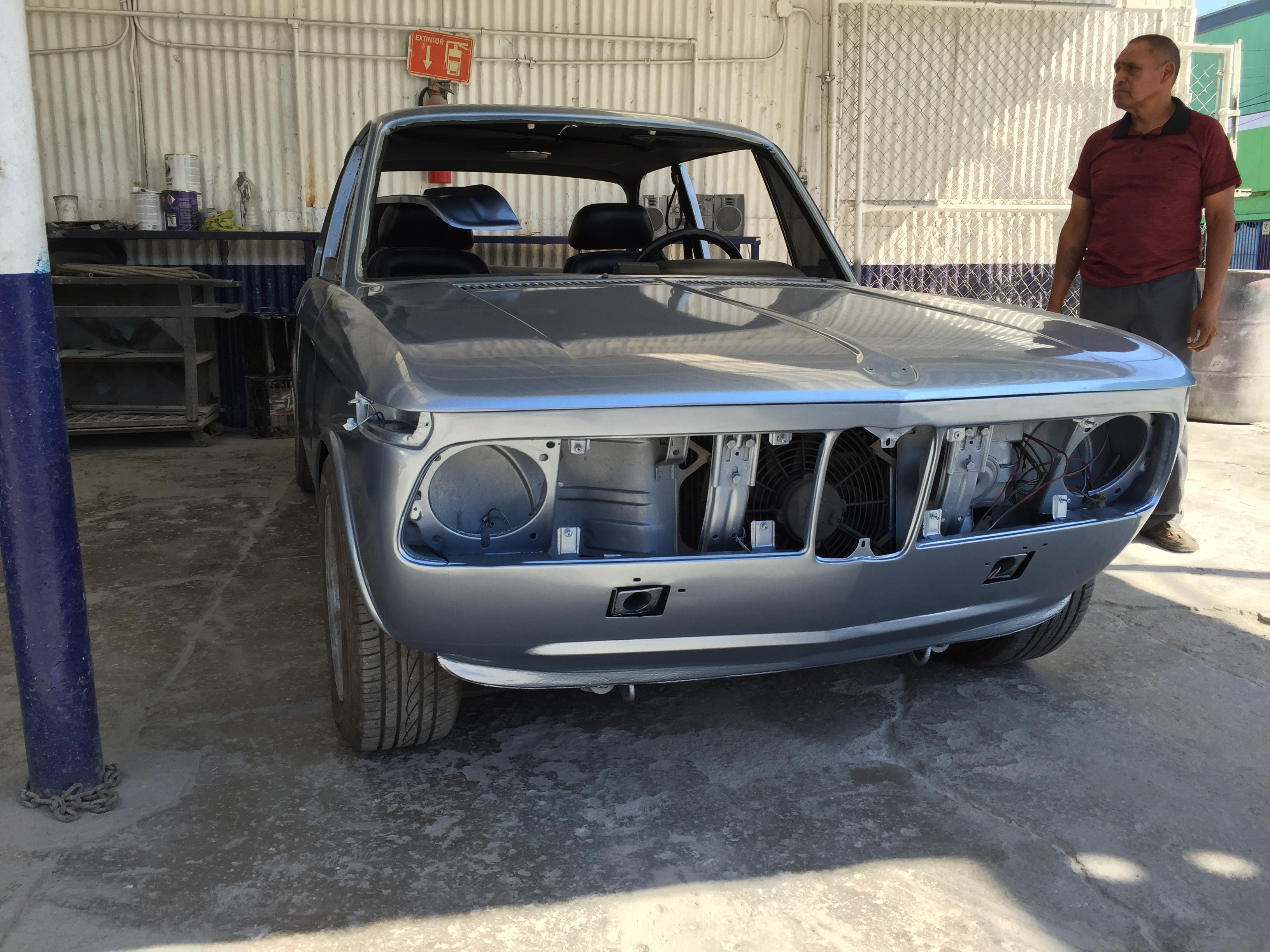

Front reflector holes patched, a dent from a ht and run repaired and big bumper holes filled. Also hidden rust near the door at the rear of the fender repaired.  I never saw it, but they found it and fixed it.

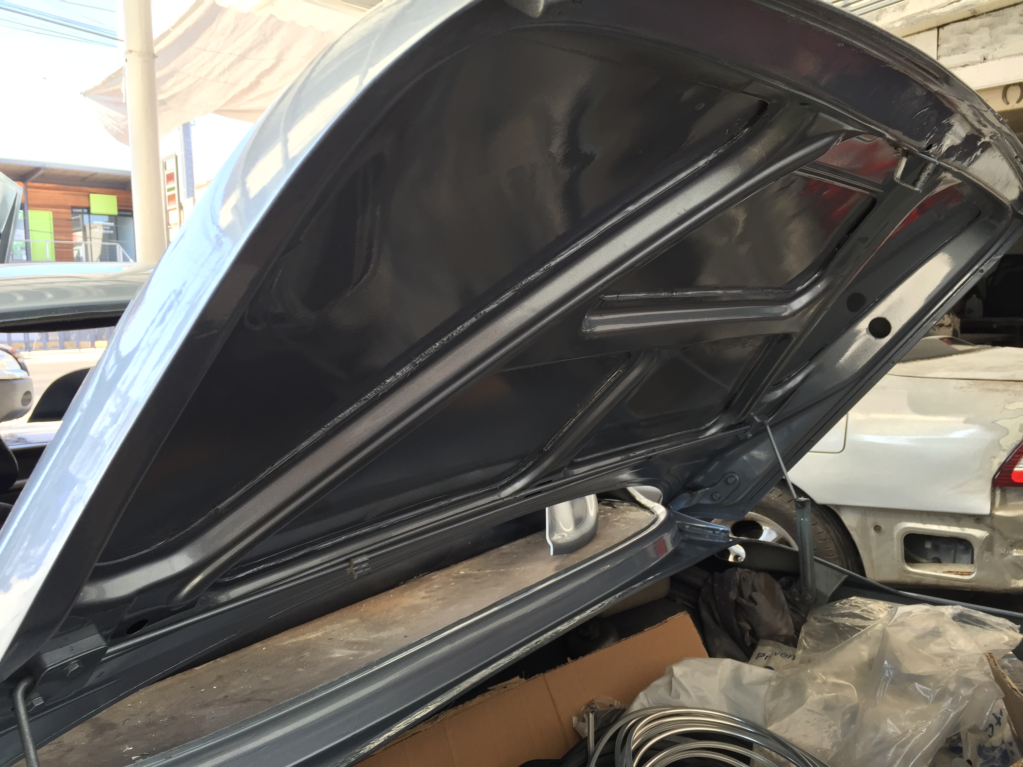

Same treatment for the passenger side fender, this one was in pretty good shape.  The hood was always damaged where the A pillar and hood meet.  Car was in a previous accident and this was never repaired.  They took that section of hood down the the metal and reshaped the hood to make it perfectly straight.  There was also a bit of rust there that was removed.

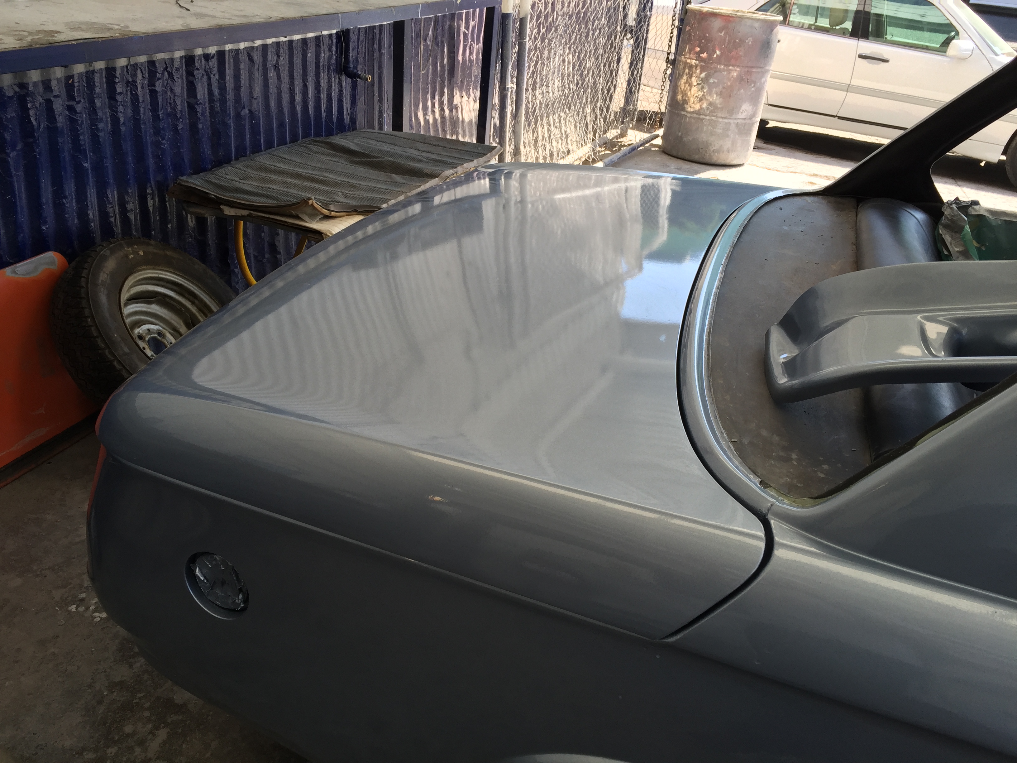

Rear end completely straight no side reflectors, those holes have been filled and again the trunk and rear quarter have been block sanded to make straight.  oles from the big bumpers have also been filled.  Rust on the drivers rear wheel arch has been repaired.

 Update: I took a trip down to see the progress of the car here are some pics of where it stands today. The headliner is done. The pain has been sprayed. They need to respray the sunroof because  it got scratched.  The windows go in in the car will be polished and wet sand this week and ready for pick up at the end of the week.  There is some orange peel in the clearcoat and a few runs but nothing that will not cleaned up in the wet sand and polish.  I will have a full write up and even more pics on my blog today when I get back home.
