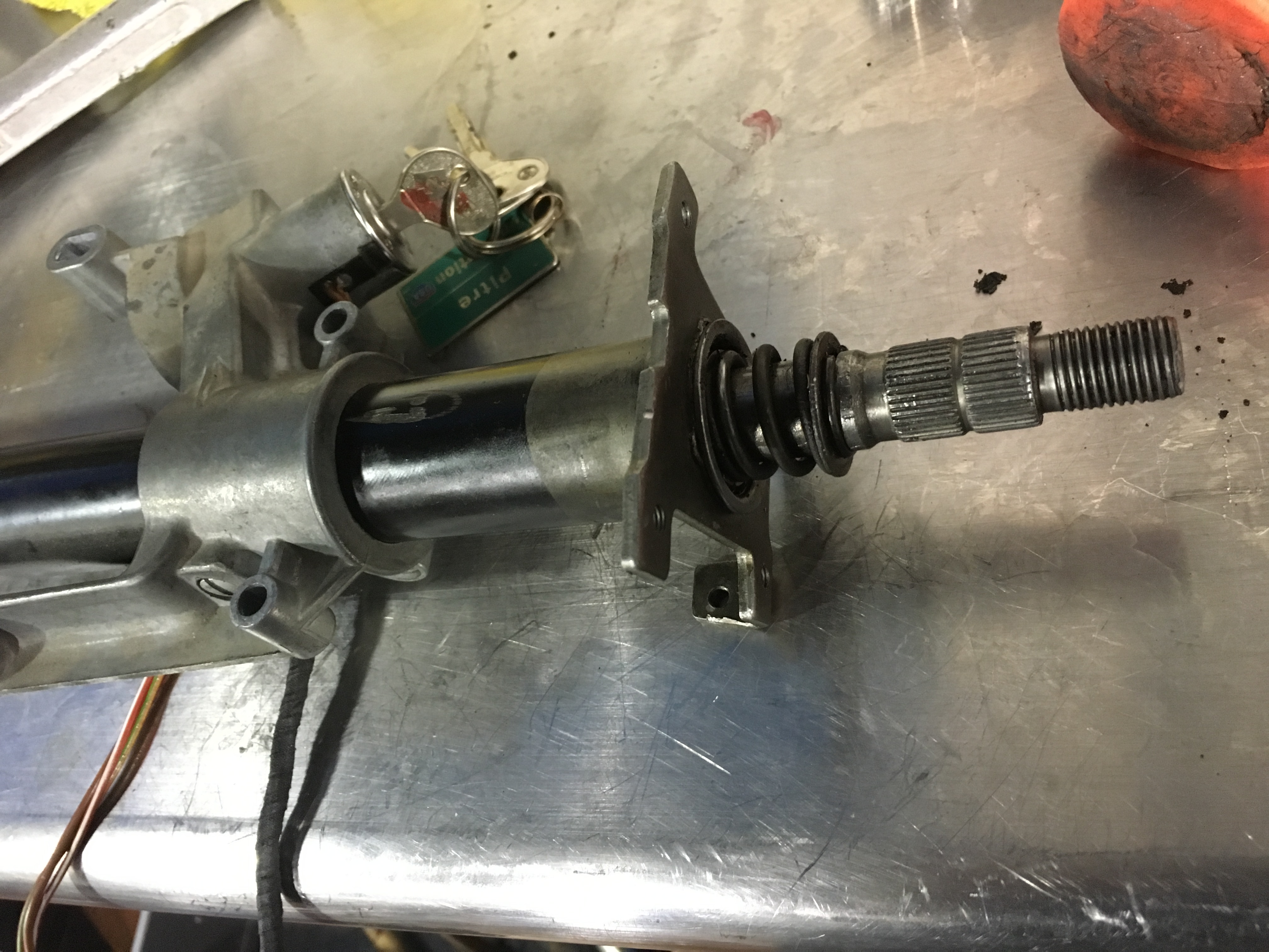

Finally!
once column was out of car, used shaft to bang out bearing from column. Make sure the key is in on so not to damage steering lock.
Bearing came apart when coming out of column, had to grind edge of bearing carrier so locking ring could fit.
Here is final picture
thanks to all for the help.
