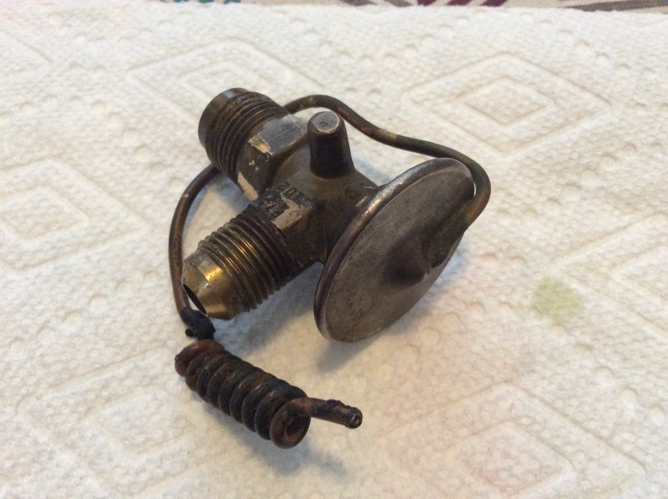

Hi all,
I'm getting ready to install A/C on my '75 and I need to replace the expansion valve on my Frigiking evaporator. Does anyone know where to get a new valve? I've looked at a few other topics on this but can't find any definitive answers, just the advice to get a new one. Here are some photos:
This this one from Nostalgic A/C looks close - will it work?
http://nostalgicac.com/driers-valves/expansion-valves/oring-expansion-valve.html

Are you going R12 or R134? If R134 you should replace the condenser and dryer along with the compressor so you will have almost all o-ring fittings anyway. If you are doing R12 you will still have mostly flare fittings. The reason I point this out is that the nostalgic AC expansion valve should work fine for either application but you will need to adapt it from O-ring to flare to connect to the evaporator and the dryer. You can get custom lines made for this (or make your own) or there are adapters. I went with new lines to minimize the possible leak points.

Those are flare fittings. Rather than cut them off and install o-ring fittings, I would use an adapter. Here is a #8 example.
http://nostalgicac.com/fittings-hose-kits/flare-adapters/8-flare-to-o-ring-fitting-adapter.html
Alternatively you could have new lines made with flares on one end and o-rings on the other.
