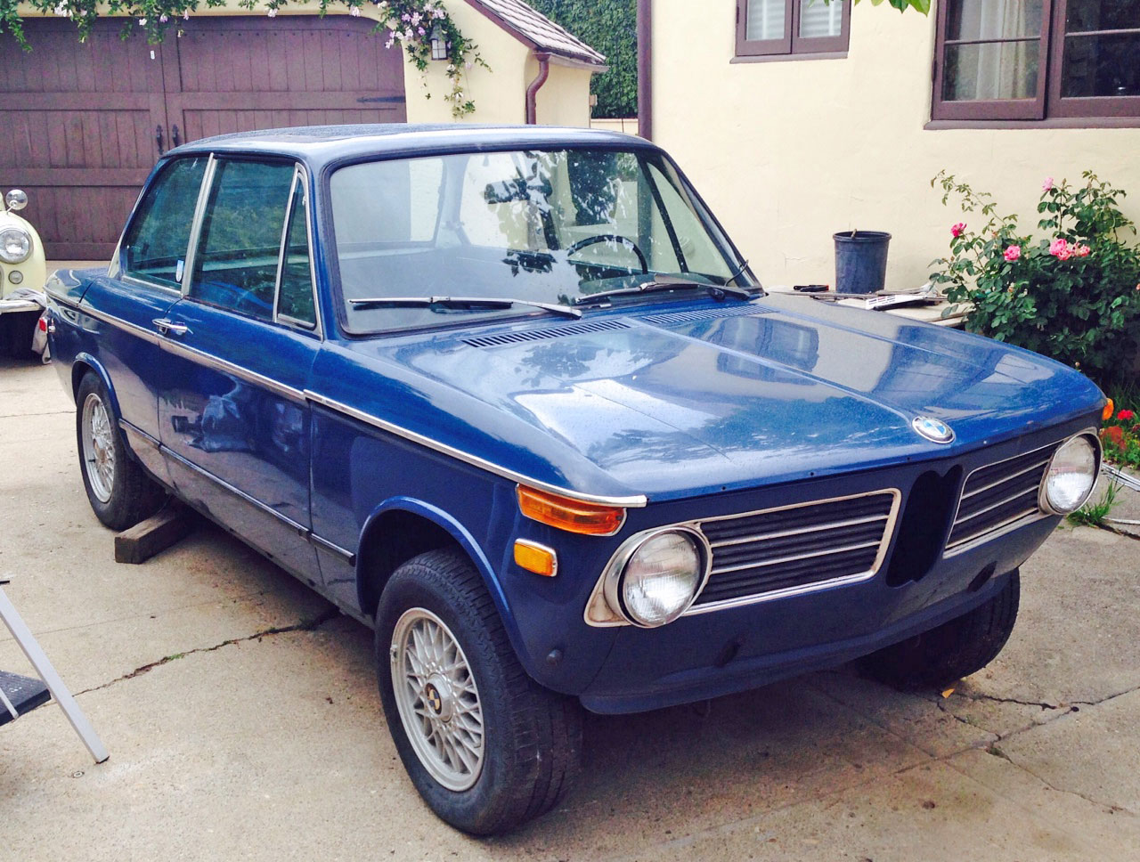

I am a newbie here  so hello to everyone, been looking for a 2002 since I sold my 3.0CS last year and have found one albeit in pieces. The car is a very straight original paint car that for some reason had been stripped and left sitting fo about 10 years. Engine was where the passenger seat should be. I have been carefully cleaning and putting things back together but  unfortunately after inspection  it seems the engine is toast, the bores were rusty and the pistons were  u.s.. I The head was actually in pretty good shape I had it rebuilt with a  reground hi lift 292 camshaft and pistons 40 over from Ireland engineering  I have a pair of 40DCOE Webers and manifold that came with the car I and  a TII exhaust Manifold, so I was thinking I should lighten the fly wheel engine builder thinks it unnecessary but I would appreciate any input I’ve reused most things from the engine except new upgraded springs have I missed anything ?? heres a couple of pics showning the car .
