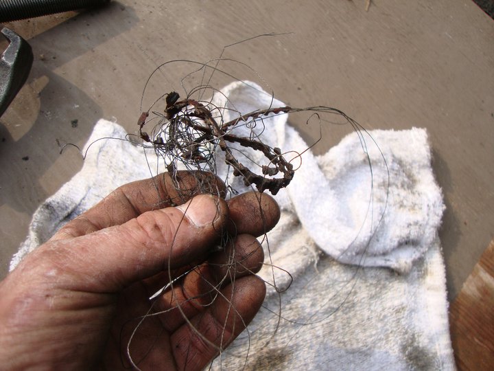

This was once a Kugelfischer belt. Worked for about 2 minutes (after the car sat for 14 years) before it completely disintegrated.
