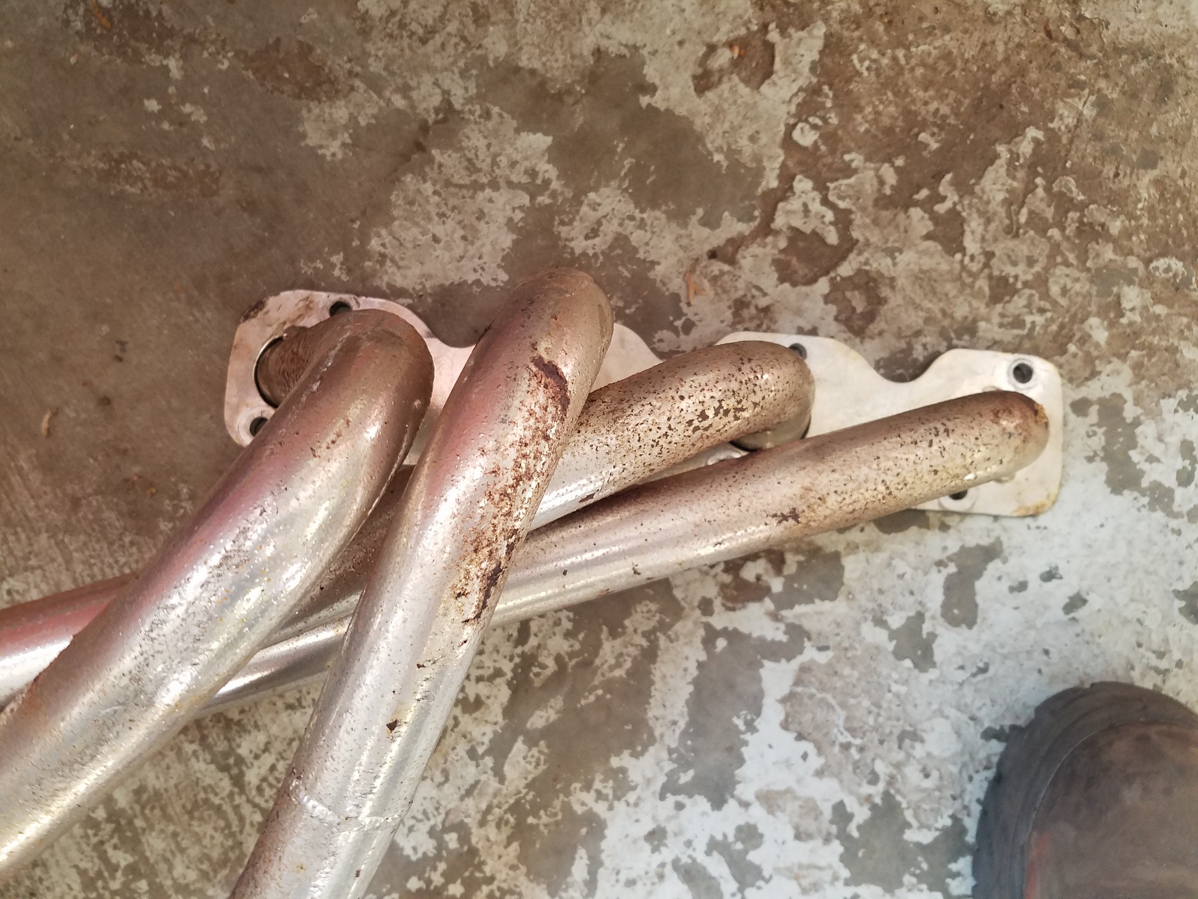

I'm trying to save everything. I moved on to the header while you guys replied. That fought me too, but I won. I think it's a fake Stahl, but you be the judge. No name on it.
