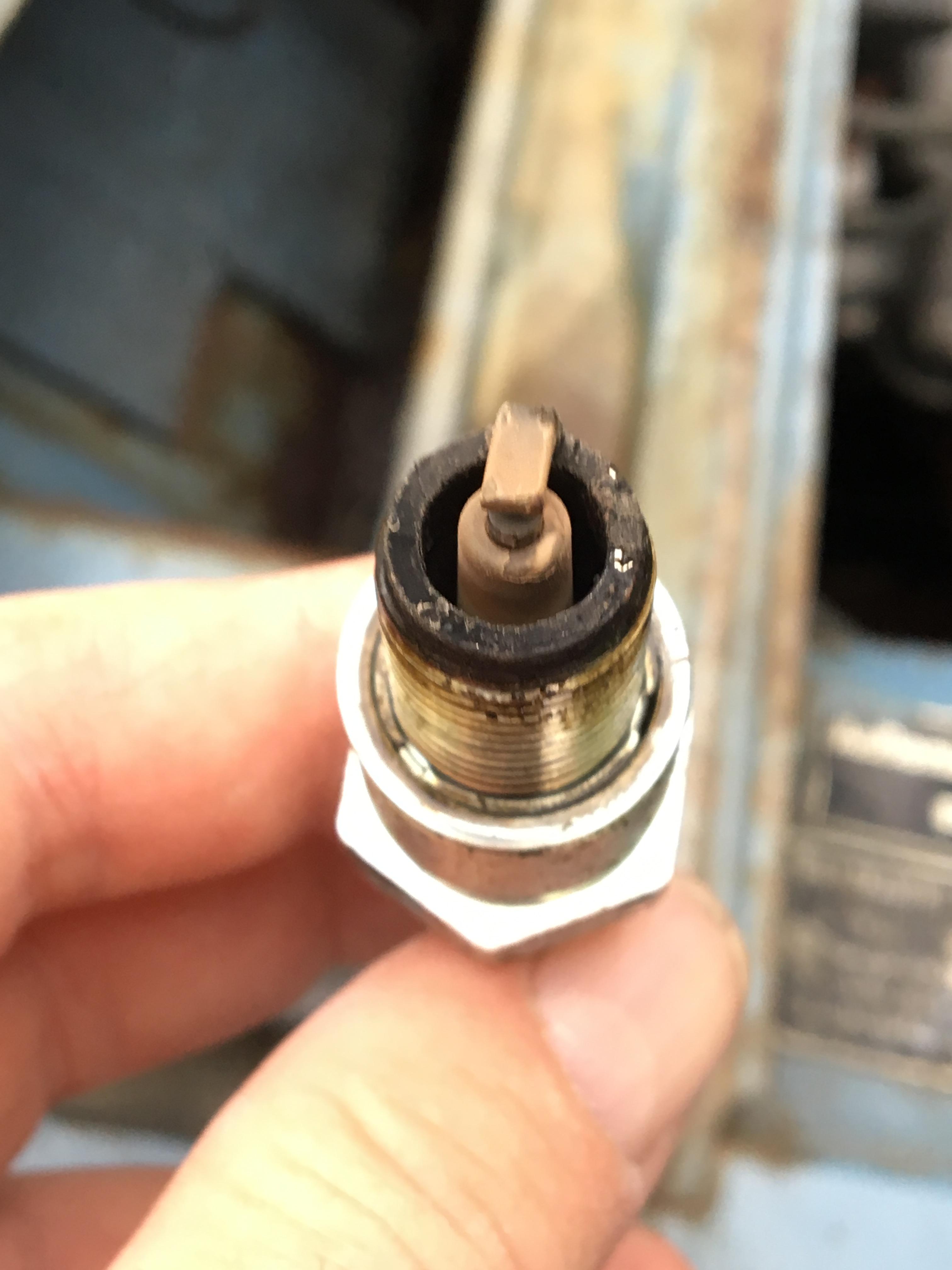

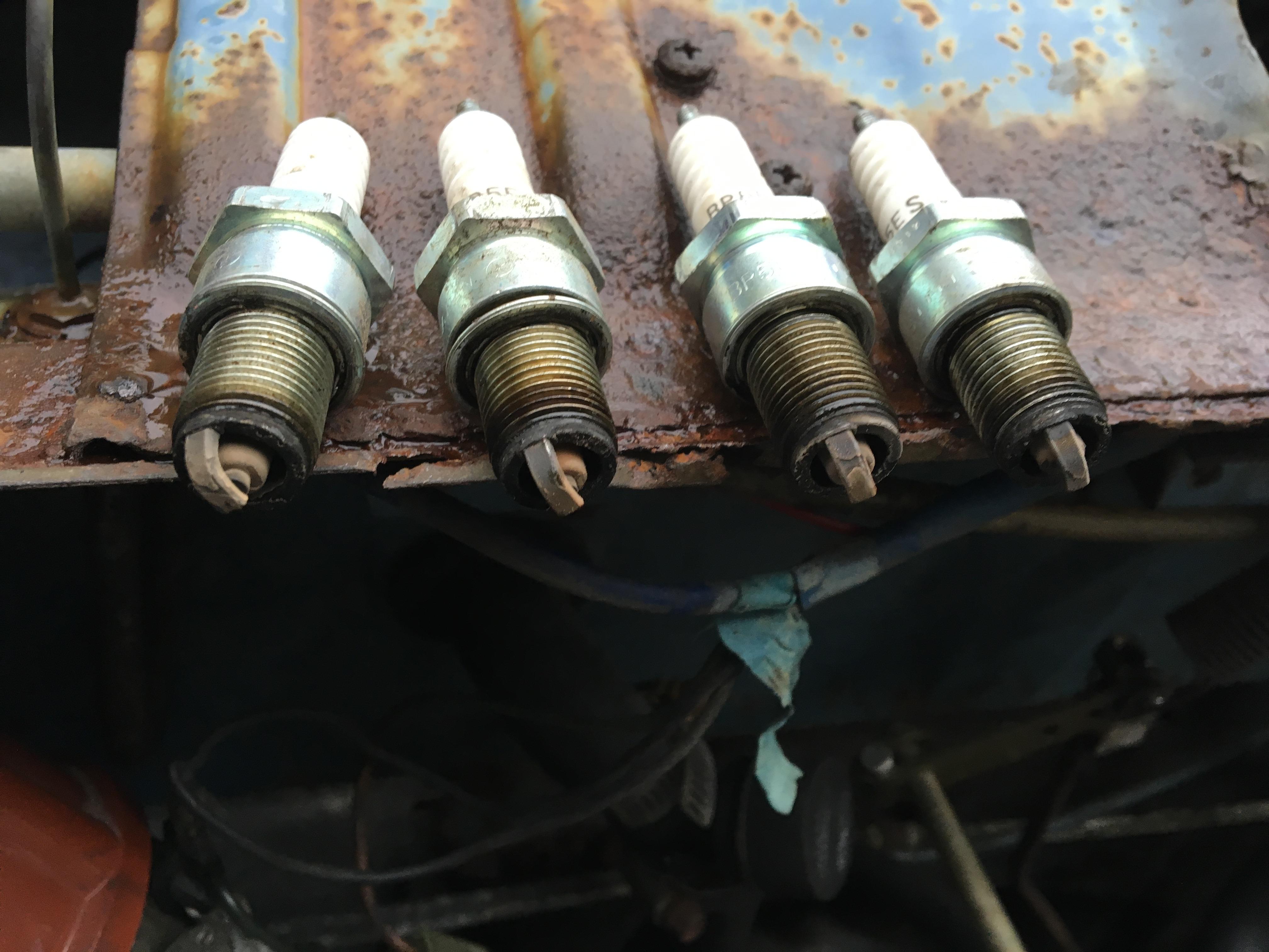

Thanks all.  I will be pulling the plugs today. Had to put a trailer hitch on the family van last night and totally forgot about the car..
The drive to vintage certainly worsened the exhaust leak in the collector.  It was louder yesterday than it was originally.  I may have to swap out the unknown, rusty header for the crusty Stahl.  I just need to weld on a new flange for the mid-pipe connection.
I will report back with plug findings as soon as I can.
The car ran fine on the way home, but I was in much slower traffic.  Its weird.
