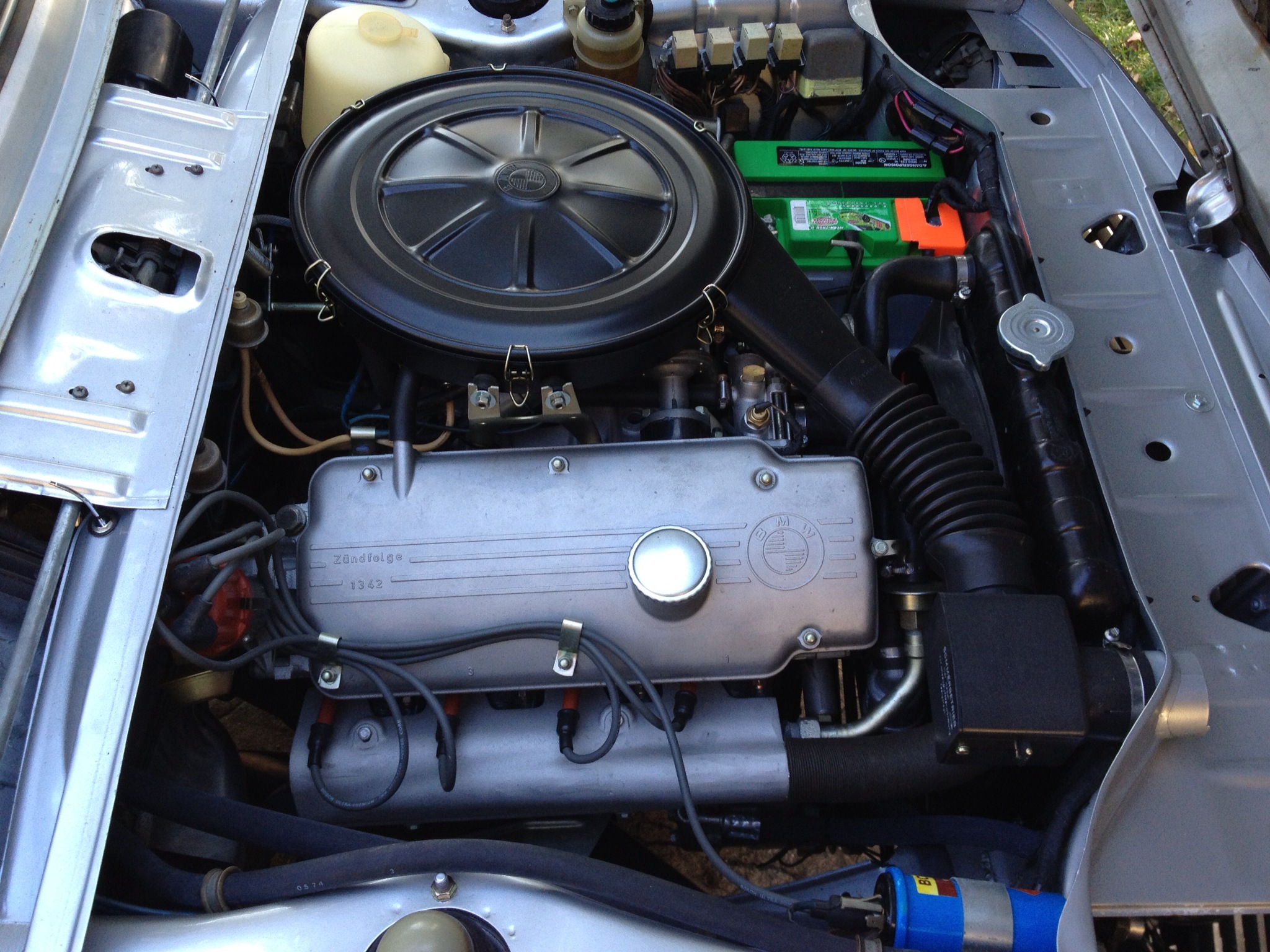

My '76 has Clardy A/C, which I installed when the car was brand new, following the Clardy installation instructions closely.  The hose running from the evaporator/blower to the condenser was originally tucked tightly against the right inner fender, as seen in the first photo, taken August 1983.  That hose is now less tight to the inner fender but really doesn't need insulation (second photo).
The hose running from the evaporator/blower to the compressor, however, runs closer to the exhaust manifold.  Originally this hose was installed in a woven insulation sleeve (third photo: you'll need to click and enlarge the photo to see the woven texture), provided by Clardy, but upon re-doing the engine, we've now routed this second hose tight against the right inner fender until it's virtually at the compressor.  We did not install a sleeve or equivalent this time and I can't say the A/C misses it.  But if it made you feel more comfortable, you could try  any insulated sleeve for this second hose:  if the real goal is heat isolation, I'm certain technology has advanced far beyond that original woven sleeve!
