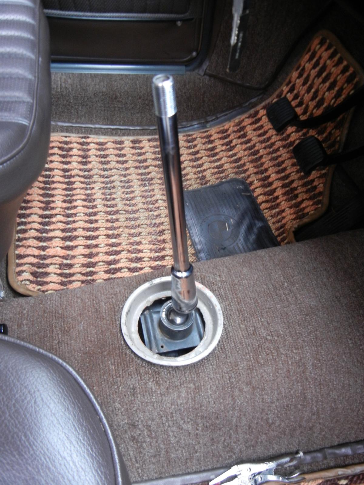

Yes indeed, the road noise is appreciably less now that the shift tower insulation is installed.
Question:
is the ring supposed to fit between the shifter support and the transmission tunnel, or between them like a sandwich?
Mine is sandwiched, but I did that without thinking or consulting any manuals.

My best guess is that the insulation is supposed to be on top of the tunnel. Looking at the set-up, it seemed like a natural fit, at least on my NK. Plus, if you sandwich the piece under the tunnel, wouldn't the insulating qualities be affected if the foam is squashed?  But really, I don't know for sure.

Mine was sandwiched between the shift platform and the underside of the tunnel. I assumed this was how it was supposed to be and put the new one in there like that. Of course my surround was the square one.
