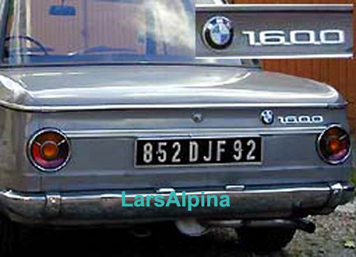

Second type from late 66 to early 68, roundel with "1600" above the chrom trim, early US cars should be like this.
post-36854-0-40832600-1389976088_thumb.j

According to your post, being as the car in question was manufactured in February of 1971, this would put me in the "Third type from early 1968 to March 71, roundel with "1600" below the chrome trim."
Good to know. I'll go ahead and use this as a foundation of information for this car.
