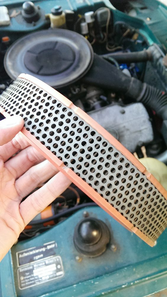

Hello,
I am continuing my first under the hood check of the 1971 2002 I'm looking after, and I was wondering how you can tell if the air filter needs replacing.  I read in a book that holding it up to the light and seeing if light can pass through is a good test, but I think perhaps that method doesn't apply to the kind of filter in this car (or it's just really dirty).  I took the filter out as shown and held it up to the sun.  I think the accordion shape rimmed with cardboard is too dense to check this way.   Was I supposed to try and remove the red parts and then check?

If you have access to a compressor, blow thru the air cleaner from inside to outside--if a bunch of dust/crud comes out, it's replacement time.
Generally speaking, if you drive on paved roads and don't live near an erupting volcano or other big dust producer, a paper air filter element will last a long time without getting clogged.  Oil wetted foam filters (e.g. K&N) need cleaning far more often, which is a good arguement for retaining the factory air cleaner if you're sticking with downdraft carbs...
