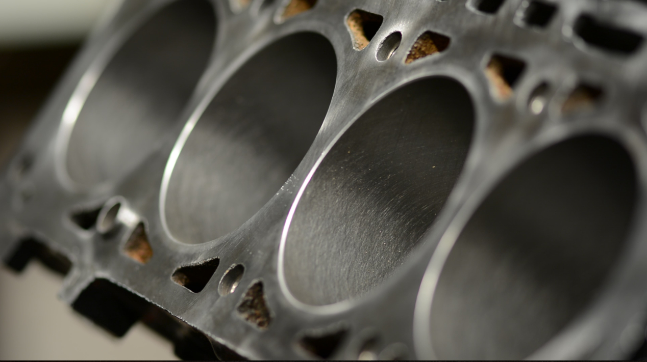

What is your break in procedure?  What did the machine shop do to the block?  Did they have the pistons in hand?
When driving i have made sure to vary the RPMs, but mainly staying below the 4000 mark. Ill take it to right around 4000 and then let it slow to around 2-3000 rpm after 10 or so seconds at 4000. Then repeat always making sure to vary the RPM. the machine shop had all of my parts, the pistons, bearings, rods everything. It has been several months since the machine shop had the block but i do know that the block was honed, pistons and rings were checked for the correct tolerances. Ill also attach a few pictures of the block that shows a bit of the work.
