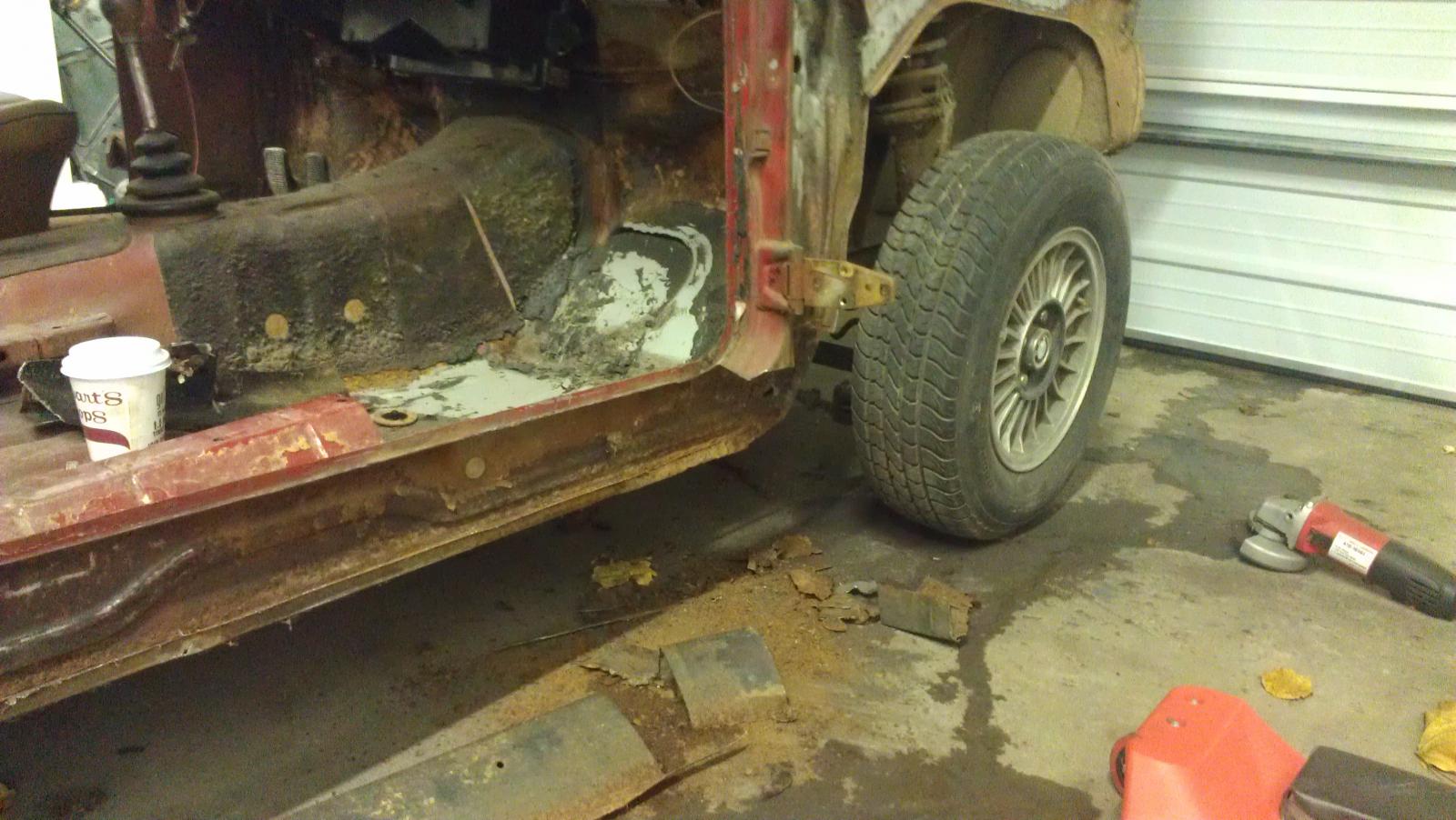

I jumped back to the rocker and where the fender mounts and started cutting the rot out, made a piece and tried to weld it in. I have never struggled with a mig so badly. I got a little 110 mig from a friend, figured it would be fine for sheet metal, and started trying to weld lol. I have used many of welders before but this has no voltage adjustments besides a couple of switches between high and low. So it was more of a trial and error for my first piece. It turned out horrible but what ever it held fine.
My terrible weld
