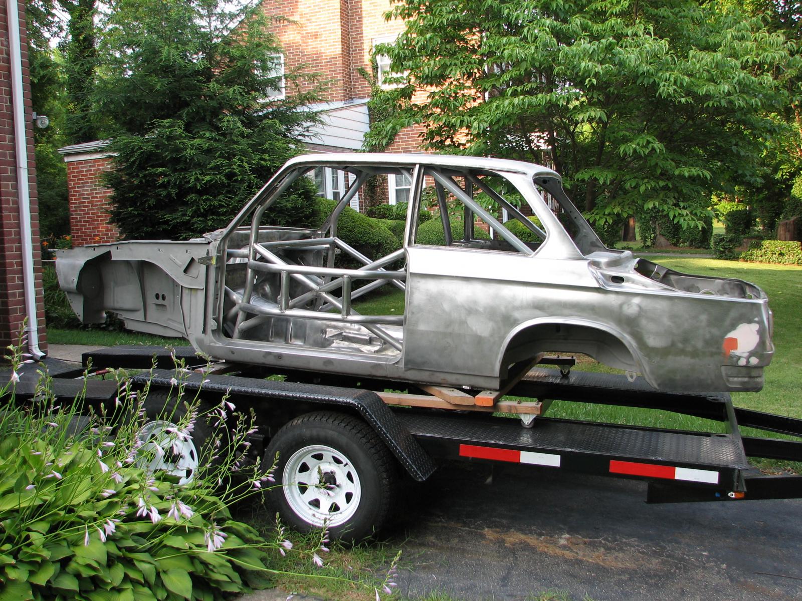

I did a bare metal resto on my '74 Colorado track car. Did all the work myself (including stripping and blasting) except final paint. Hand painted entire car with POR-15, then primed with POR-15 primer using a small cell foam hand-roller. I think the final paint shoot was about $3k from a guy who normally does body work but I talked into doing the full shoot. Including the rest of the build (full cage etc) I estimate 3000 hours of my time. even if a shop could do it in 1000 hours, at say $60/hour that is $60,000 + parts!
So, if your rust is minimal and this is more a track/project car than a show car, just have the body shop fix that. Then strip off all the trim and remove windows, and sand the entire body to rough it up and then pay a shop to prime and paint. If you go all the way that is great, it is very rewarding, just realize it will take several years to complete, no matter what the body shop tells you in the beginning.
