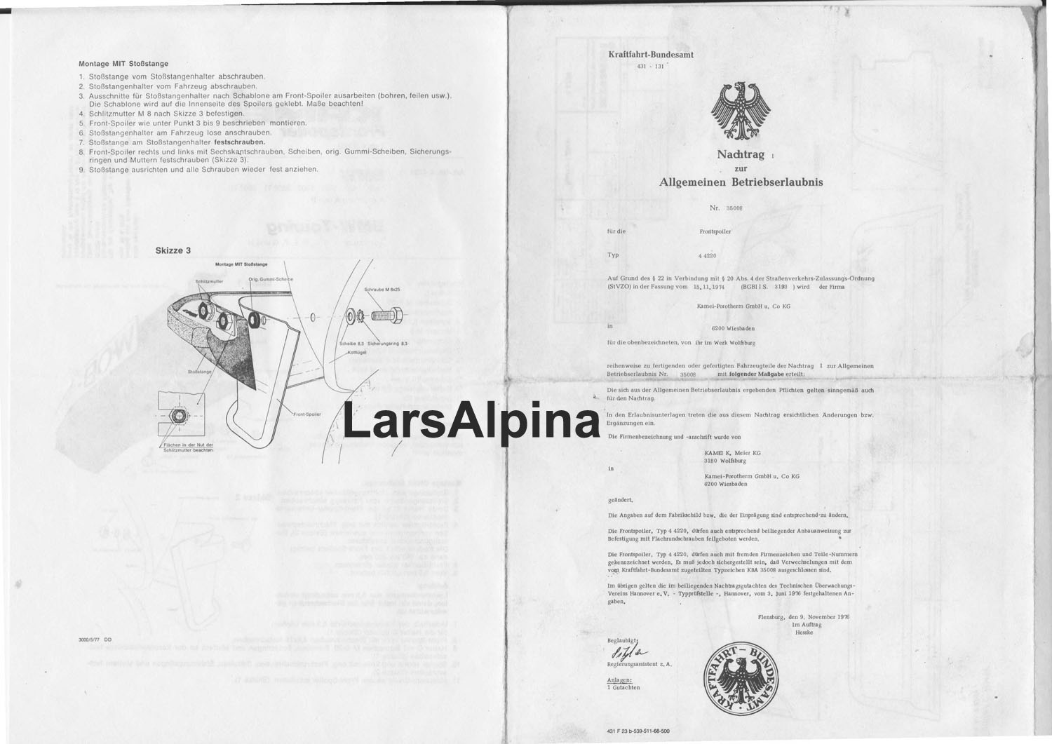

I just purchased a spoiler from Pierre and have been deliberating on how to attach it. My searches show that there are several ways to do it with riv-nuts being the most preferred. No problem with that. I would like to see some pics of people who have installed a spoiler /air dam but with the focus on how the screws look.  I am interested in screw type, size, material, head shape, etc. So close up pics would be great.
Thanks,
John
John,
below you find scans from the original german Allgemeine Betriebserlaubnis for the Kamei. Installation guide and material list are included in this papers.
post-36854-0-79961400-1377761611_thumb.j
post-36854-0-96989900-1377761629_thumb.j
Best regards, Lars.
