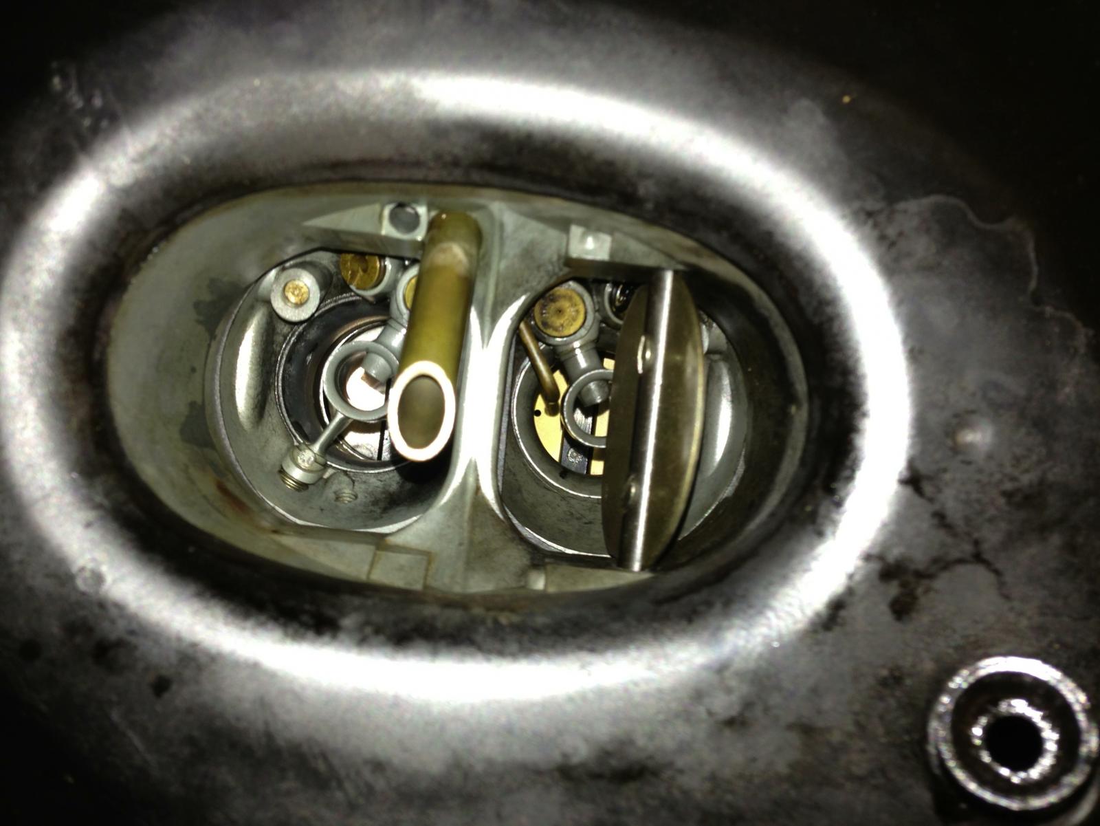

Stock solex carburetor throat:post-45574-0-12827200-1375698239_thumb.j

Check the spark plugs and distributor. Definitely clean the fuel system including the intank fuel pickup filter. Also re-time the engine.
