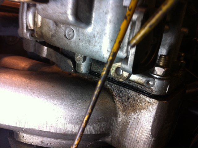

got any photos of inside the carb and surrounding
area - we might SEE sumding ?

YIKES! Ola -
i was just about to say " look at the carb base"
mounting after looking at your photos and then I
see you already found IT!
try installing the 2002 carb insulator block with paper gaskets.
Provides a better seal, heat isolation, soome vibration
dampning. Look for the bmw part number
in the 'parts book'. The carb never does well without a
bmw fiber-block or after-market rubber insulator block.
Pierce Manifolds Calif.
SPACER BLOCK 7mm
No. 99005.119
....and double check that those AUX VENTURI's are tight.
if the ends fit loosly and they are able to wiggle any
in their slots the motor will run snotty!
