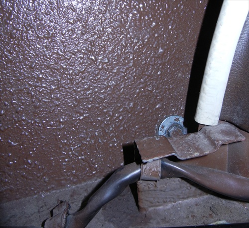

I am trying to remove the rear bumper - 5 of the 6 bolts in total come out easily, but this one just spins. Does anyone know, is there a cage nut in the bumper itself? As the bolt is recessed I can't exert any force on it to "pull" it out. Any suggestions for yanking the thing?

No cage nuts or any other means of attachment in the bumper itself. The bumpers are mounted using carriage bolts with a square under the head that fits a slot in the bumper tab.
What's probably happened is the slot has been rounded by turning the rusted carriage bolt.
You'll have to find a way to cut the bolt or the nut.

Thanks, Neil. I wonder if you are referring to the set-up shown in the pic below, that I don't have. My bumper matches the one in the diagram, with only a hole for the carriage bolt in the bumper, no slot. I got the bolt from the p/s out no problem but I still don't know how it's fastened to the bumper...

Yeah, it's not an issue to get a hacksaw blade and cut thru the shim to get the bolt off, but I wonder what I'll find. For now I think I'll leave it alone - until I can determine exactly what fastens that bolt. Looking from underneath the bumper I can see something round and rusty inside the bracket that must be a type of nut. Beyond my level of knowledge.
