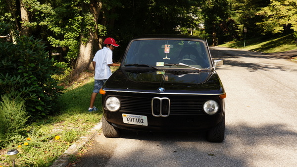

The car is in Blacksburg, VA. I has been a daily driver for past three years and I feel the time has come to give it a good cleaning, fix some of the major issues and make it last a lot longer. The rust is not that horrible, but that is just my view. I am sure some of you will think it needs a ground up restoration, I just do not have the resources. My goal has been to strip the old carpet, get rid of all the "professionally" body filler jobs, patch the holes with fresh meta and in the process learn a lot about my little car.

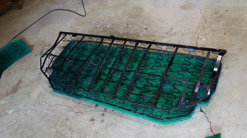

I do have to replace the floorpans. Patchwork is just not going to cut it because I plan to put in new carpet, the rear seats have been re stuffed and look good, but I I do not fix the rust holes (millions of tiny ones) it is going to eventually come back and bite me. So, I am going to do it.....or give it my best shot. You must have already noticed my noobie welding skills, but the point is to make the car better while I learn complimentary skills during the journey.

  6. I did a DIY carpet job, 20 dollar outdoor black carpet and two rolls of universal carpet. Again the idea was to make the car better as I can not afford to make it perfect.
