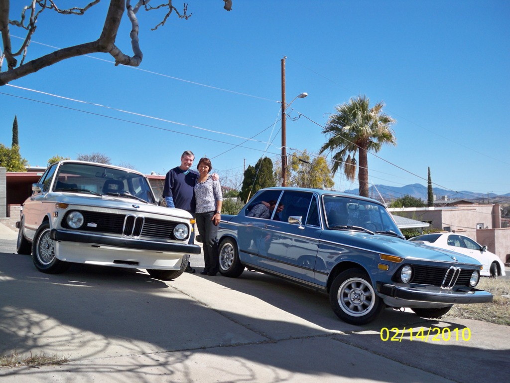

I'm running 14" x 6" Superlites with H&R Sport Springs and Bilstein Sports on Hugo (see my pic)...it's stiff but no clearance issues at all.....sorry, I don't remember the offset....seems like it may be ET20....I can confirm if you still need it.

Do you know the offset? If I recall, you bought the same wheels I have after you asked me about mine.....after seeing the ET26 offset mentioned, I am thinking that is the offset of these 14"x6" Superlites....sounds very familiar. I looked at my wheels and the offset isn't stamped on the outer side, but I'm almost positive it's 26mm come to think of it! And my lowered '72tii has absolutely no rubbing even at full lock! Of course the tire size needs to be correct to avoid rubbing as well.

Nice Ray! I thought Hugo was lowered....your car looks awesome! Great color too! :-)
