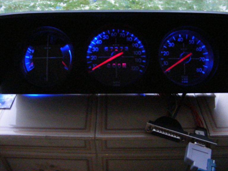

Just converted mine using Switec stepper motors controlled by an Arduino.
I butchered a VW instrument pod for the motors and illuminated needles.
I buttered a VW instrument pod for the motors and illuminated needles.
I have no idea what that means...but sure looks nice!
That is boss right there. I was just reading a hackaday article on this. What are you using for speed sensor?
Cheers, I'm planning on using a proximity (inductive) sensor on the CV bolt heads. Arduino will take a pseudo interrupt type input on the serial line but haven't tried it out as yet.
