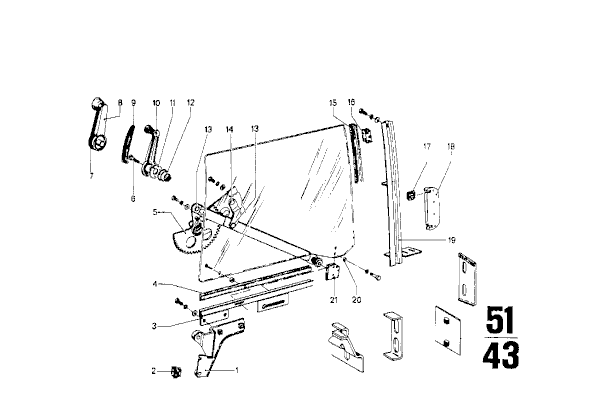

Put some replacement doors on the '72 for paint job. As I'm building them back up, I found that I am missing a piece from the guide. On the picture below, it is #2. I don't see a part number in realOEM. The window worked fine before without it... what is it's purpose?

glass can more easily get cocked in its channel and not want to roll up smoothly. It'll work without the piece, as you've discovered, but will work better if you have it. I don't think the factory would have included it if it wasn't necessary!
Perhaps someone has a derelict door with the part you need...
Look under the Parts For Sale section on this board. There have been a couple of cars being parted-out recently and they may have that piece that rides in track. As mentioned above, you do want to get that piece installed in order for the window to go up and down as originally intended.
Before replacing the door card/vinyl use some Wurth HHS-K spray synthetic lubricating oil in the window track, both front and rear.
