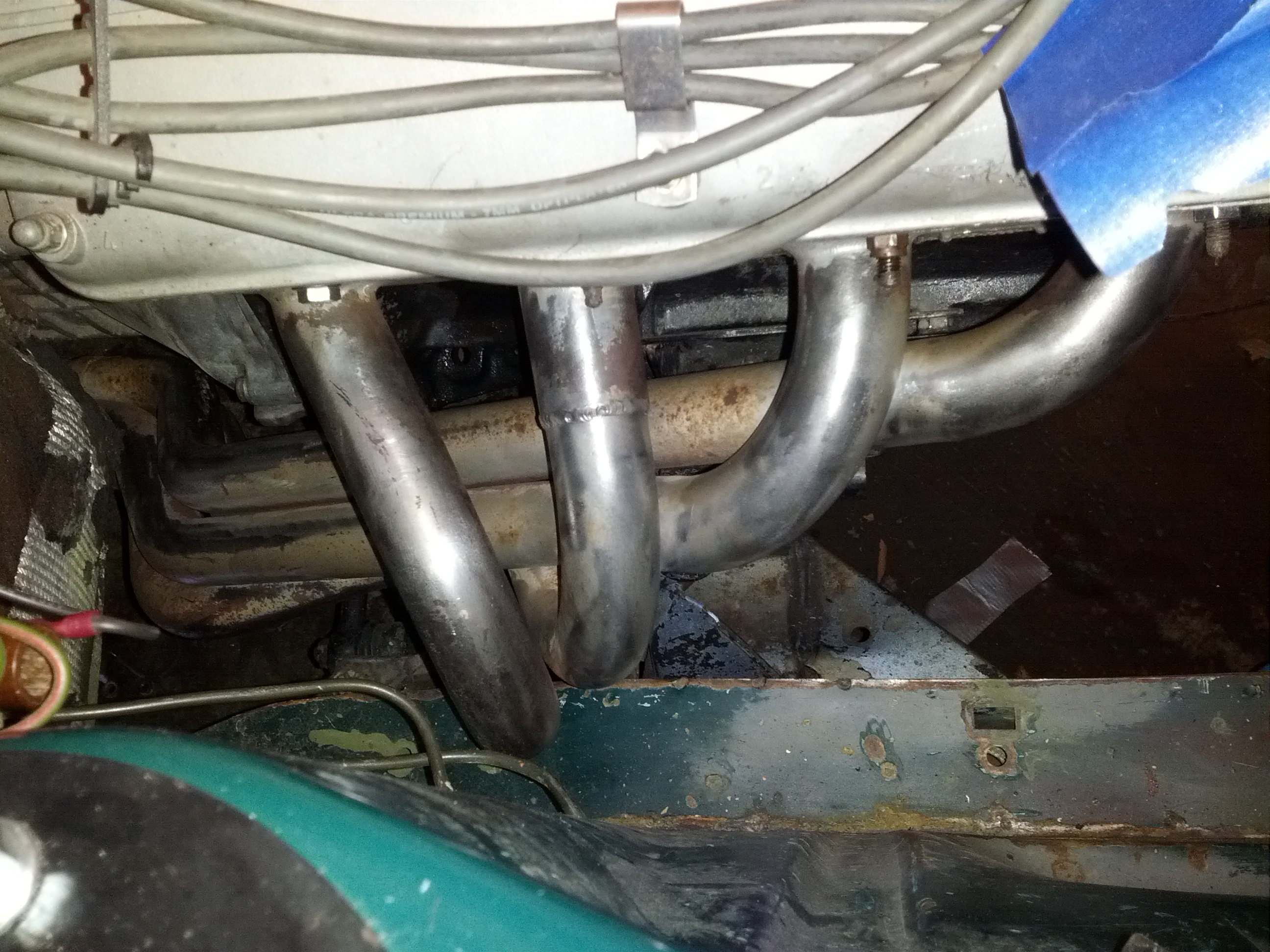

Installed Stahl header, AFR through the roof.
cxzsaq
72tii.
Got the Stahl header installed.
Car ran fine before, 13ish afr, no issues.
Now cold idle is 17+, warm/hot idle is the same.
Intrestingly, I now have a very light exhaust fume in my engine bay. Checked head flange, collector on bottom, seals, NOTHING!
Yes, it's the correct header model (called and confirmed serial number).
Checked throttle linkage, all good.
Warm up regulator is good too.
Why would there be a change?
Why do I smell exhaust?

I think you have an exhaust leak somewhere which is letting in air and letting out exhaust -- explains the smell as well as AFR. At idle, the air inflow is not limited by the exhaust, but by the throttle valve, so changing header should have no impact.
Back to basics. Where is your 02 sensor installed?

As mentioned, you have a leak somewhere. If you somehow don't, I'd check the sensor and make sure it didn't coincidentally die on you.

17:1 air fuel ratio is lean. At idle there is very little flow in your exhaust system compared to wide open throttle at high rpms. I don't see how a exhaust system change would do much to a four stroke engine at idle. But I am not a tii guy so perhaps you will teach me something.
IMHO
1.Air leakage into the exhaust stream is the most likely culprit. You smell exhaust and air can leak into the exhaust. Wave dynamics in exhaust systems can do funny things. Because of this I would suspect a leak or leaks is located upstream of the collector. Excess air in the exhaust would also explain the high AFR. Make sure you check around the O2 sensor for leaks especially if you did not replace the crush washer when swapping the sensor to the new exhaust and or did not torque it to spec.
2. Is your sensor heated? Is it still working properly?

Thank YOU all for contributing with suggestions. I am happy to report that the issue is resolved.
The fix was as most of you suggested - an air leak (literally a pin hole) in the exhaust - and in my case, before the O2 sensor.
Specifically, the leak was at the 4>1 collector (under the shifter) and once covered up - the car started up and ran beautifully. Unreal!!!! AFR was nice at cold idle and slowly crawled up to 13ish as it warmed up (in-transit pic below).
The header definitely sounds very nice - a little louder than the tii exhaust.
However, we should not give all the credit to the air leak. As reported by me in the post below, I installed some modifications earlier and had some initial issues. These have been resolved with the proper installation of the sticker and NOW, with the Tii motor + Stahl header + sticker i feel that i got a complete package and am ready for the track. : )
