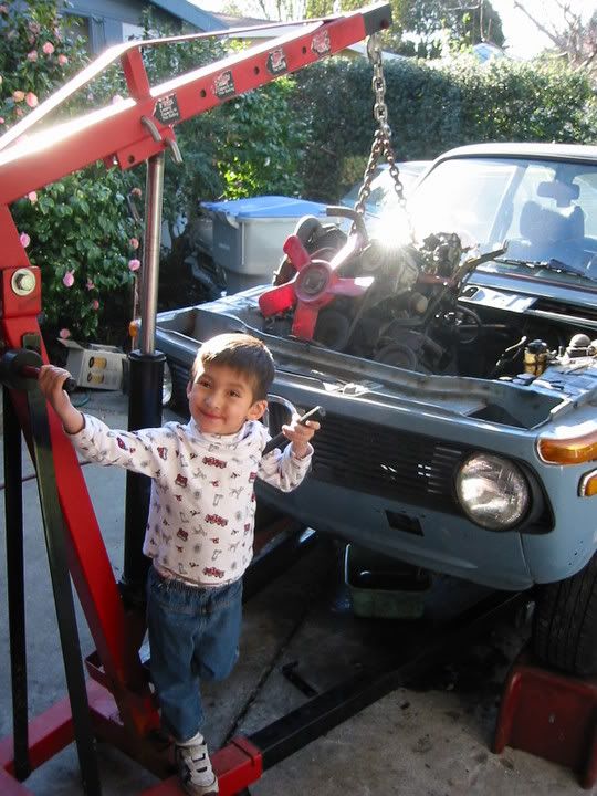

My son enjoyed that part.
And a new one was dropped in - at least for a test fit.
